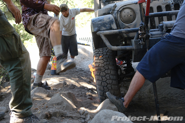

BTW, not like I've ever seen it but, here's what can happen when you DON'T remove your 35" tire from your Jeep and DON'T remove the valve stem core and this is to say nothing about using a hammer to equalize the pressure.
Between the growing fire, the precarious Hi-Lift starting to fall from all the kicking of the tire and all the guys standing on the cliff side of the falling Jeep, there was just so much wrong going on that it was any wonder that nobody got seriously hurt.

...BTW, not like I've ever seen it but, here's what can happen when you DON'T remove your 35" tire from your Jeep and DON'T remove the valve stem core and this is to say nothing about using a hammer to equalize the pressure.
Agreed, the above pic is all kinds of bad stuff waiting to happen. We can not fix stupid :)
