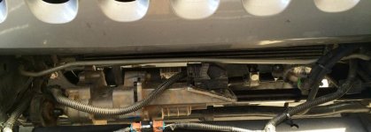

Same, mine touches but I haven't had any problems so far. I've been wheeling it like this. View attachment 99841
I would like to warn you and yolo that anything that is touching WILL eventually cause wear and line damage. All it takes is persistent vibration over the span of a year or so to cut through those soft lines.
This is the whole reason for the recalls on the '13 wrangler where the tranny line and power steering rub causing damage and a hole. I wouldnt Zip tie, I wouldnt let anything even slightly touch. Either bend it out of the way GENTLY, use a spacer on the sway bar to lower it slightly, or rotate it the oposite direction. :twocents:
